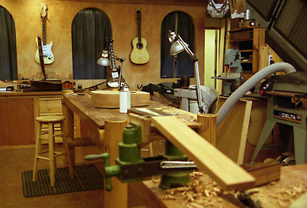

And while you're at it, faux finish it and put some contemporary accent and task lighting, for a flair of romanicism. (women will visit your shop, yes ?)
Daniel Strickel's shop, I think...
